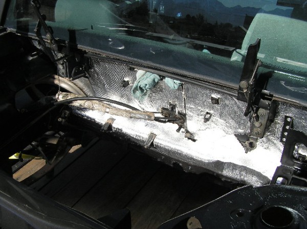

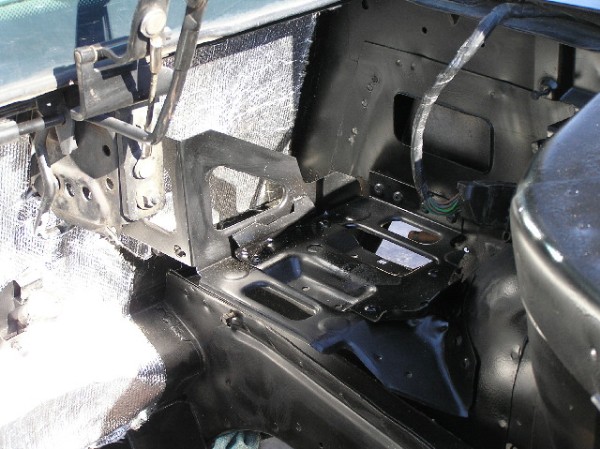

Heres a picture of the firewall insulation that fieroX was selling a while ago. I bought the precut firewall shield and then i bought some extra material because i covered the trunk wall behind the muffler to keep the trunk cooler.
Edit to add pictures
Wow, your car is coming along so nicely.
