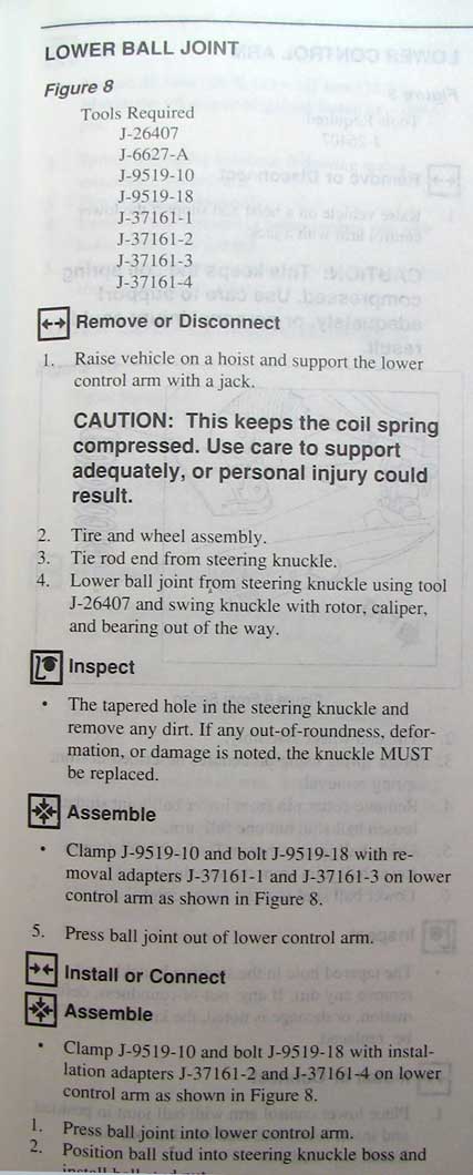

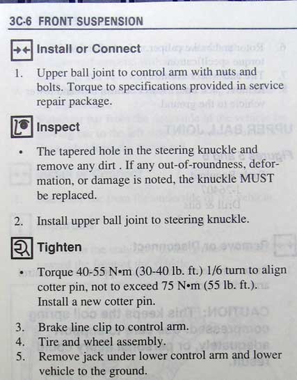

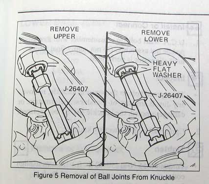

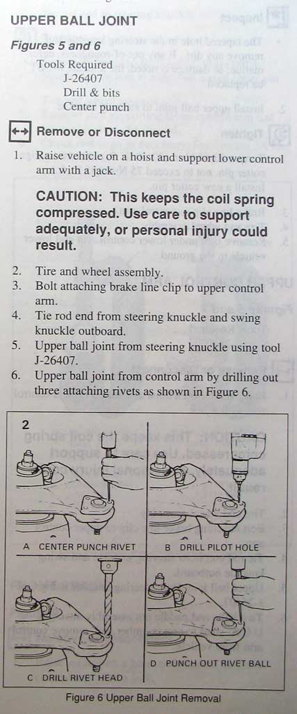

If you haven’t got the "88 Big Book" you might want to look into it. They are chocked full of so much more info than the Chilton’s and Haynes manuals.
Especially if you are getting into the end of their usefulness, this will really help ya out in regards to repairs that you are looking to complete.
I snapped a few pics of the Ball Joint Repair Section out of the book so that you can see what they are saying that is required for removal and replacement. I had to resize and alter the coloring on it, so if you like the full size files, they are large, LMK and I can E-mail those out to ya.
Upper ball Joint - 88 Fiero

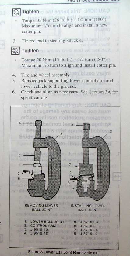

Here is the lower, I was unable to get 'em all in one thread.
Lower Ball Joint – 88 Fiero
Also, you might want to contact a guy that goes by the name "Maldo" for your shocks. I know that he sells the KYB's for less than Summit, TireRack, and about everywhere else that I have been able to find 'em. He can be contacted here:
