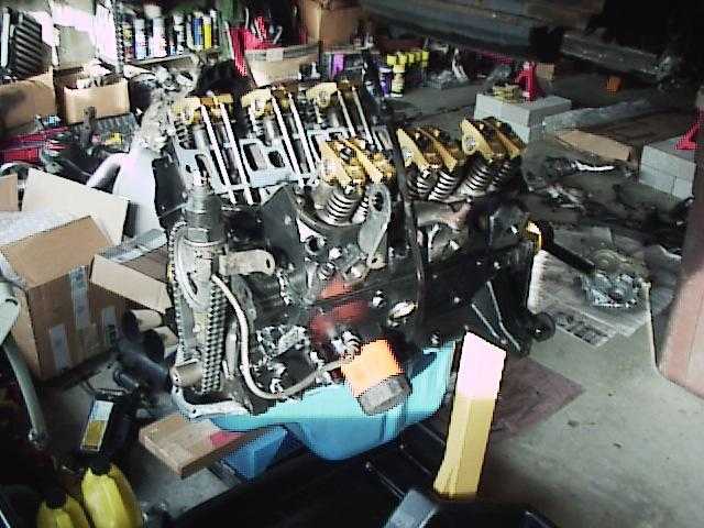

Report this Post03-16-2005 07:39 PM Click Here to See the Profile for avengador1Send a Private Message to avengador1Direct Link to This Post
Are these what you are talking about?
