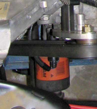

Here is a picture of what it looks like when installed:
( sorry that they are not larger, but you can get the "jist" of it )
The First one has the filter removed, and the 2nd is looking straight down from the top of the decklid on an 88.
