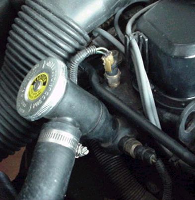

There's not that many sensors in the head, look for one with this kind of connection:

It's the one mounted in the head. The one in the filler neck is for the ECM.

There it is!!!! Just went out and found it... Now all I gotta do is test it tomorrow. Read another thread on how to do check the wiring, so I should be good to go.
Thanks JazzMan & spark1 ... I appreciate the help!!

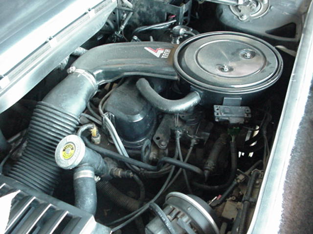

BTW spark1... if that's your engine... it's a damn sight cleaner than mine... these Ohio winters are murder on a car.

Yea, that's mine. A little dust but no rust.
