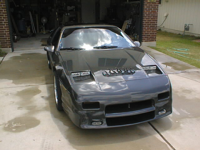

Get the fiberglass looking dremel cut off wheel. they don't break and cuts way better than the ceramic ones !

a router that you can set the depth on, especially when you're trying to cut down to just one layer. use a good 1/8" bit. i've done dremel and jigsaw, but i borrowed one once and it was so much better i got one myself.
