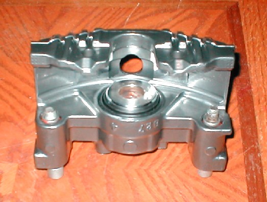

used this stuff they had at autozone, comes in a little can and a brush good thick stuff haven't had fading or nothing yet. I tried high temp paint once, but didn't turn out quite as well.
I know it isn't pretty the middle part that is I snapped a shot off before painted the middle if I'm not mistaken.
