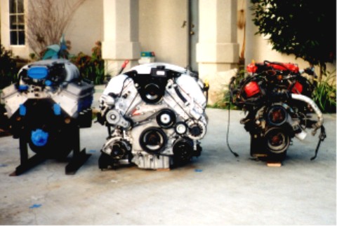

Originally posted by carbon:
Three extra cams, extra timing pullies, twice as many valves, more material in heads for all that extra stuff... it adds up. But then its 275/300HP with the 4.6 vs. around 200 for the 4.9...
The real kicker is that the 4.9 weighs about the same as the stock 2.8 pushrod.
Here is a nice comparison of an SBC, Northstar and stock V6. You can see the Northstar is huge.
Rickady88GT
Posts: 10649
From: Central CA
Total ratings: 202
Report this Post04-09-2005 04:08 PM Click Here to See the Profile for Rickady88GTSend a Private Message to Rickady88GTDirect Link to This Post
That is my L98 Vette engine that I sold to buy that S* engine. And the Fiero engine is what came out of the GT to make room for the S*.
That S* has the same exact style heads as the 2000+ N* heads. GM used the 2000+ N* cylinder head style on The S* before it was used in the Cady V8 N*.
jscott1
Posts: 21676
From: Houston, TX , USA
Feedback score:    (15)
Total ratings: 415
Report this Post04-09-2005 08:23 PM Click Here to See the Profile for jscott1Send a Private Message to jscott1Direct Link to This Post
I didn't know that was a S* in the pic. Although I suppose from that angle a N* would look the same. Interesting concept to line up the motors.
