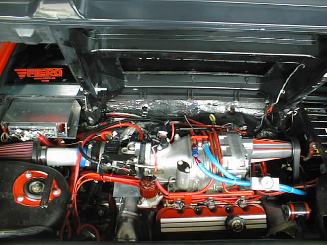

upper left or under driver vent

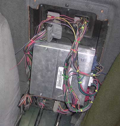

Duck:
DO NOT PUT IT WHERE REVINS IS
The OBD I is not a sealed ECM, and the harness that you have has been wired to be installed ( or it was ) in the center console of the car where the stock ECM was placed.
If you put your 95 ECM where Revins is, you will have serious issues as it is not H2o resistant, and will cause all kinds of issues.
When your harness was first designed, this is the location to which it was to be set:
This was taken before "clean up" could be done on it, but you get the idea of the location of where it was originally designed to be located.
Hope that helps...
