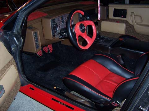

i installed a APC steering wheel with a grant adapter. worked perfectly. my question is, how do i hook up the horn? my car is a 87 GT. there is a plastic tube with a pin and a spring for the horn originally. HELP??
