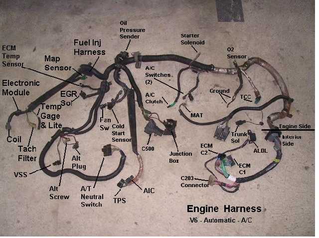

I like to document as much information as possible for future reference. There are times when I need to reference an area on the harness but could not remember where a certain connector was located. This is especially handy when doing a swap and need to remove, relocate or add connectors. So I took a picture of the stock harness and labelled the connectors. I'm sure someone else may find it helpful to have. It's for a V6 with a/t and a/c. The hardest part was to spread the harness so all the connectors are visible. Couple of booboos, the "Temp Gage & Lite" connector disintegrated when I took it off, so the two wires are bare, the 6 wire "Fuel Inj Harness' connector is not very visible, the two "Ground" wires are actually eyelets and happen to be sideways when I snapped the pic, but the rest seem to be clear. If not, please respond to the thread and I will try to explain better for everyone else to know. This information is most valuable to first timers.

Very handy diagram that you put together. Yoo dah man!
