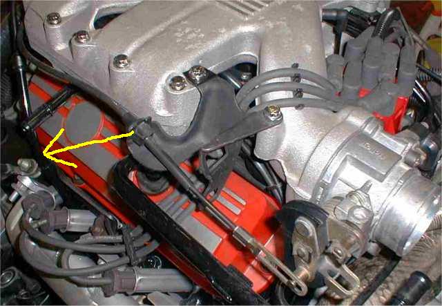

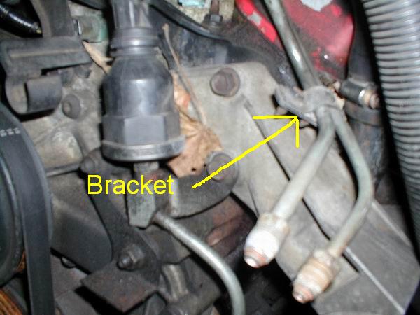

Its the front bolt ( manifold side ) of the firewall side head ( cyls 2 4 6 ), out closest to the front of the engine ( pulley end ). The bracket that supports the fuel rail lines goes on it.
Here's the best pic I could find - courtesy of Jazzman. I put an arrow pointing to area the head bolt / stud goes.
And a picture of that bracket

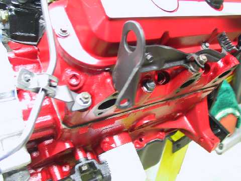

Here's another pic to add to Jazzman's and Jelly's
