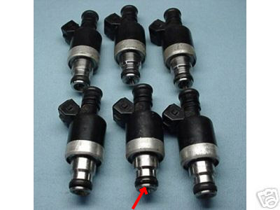

Report this Post11-21-2004 11:51 PM Click Here to See the Profile for ryan.hessSend a Private Message to ryan.hessDirect Link to This Post
Originally posted by $Rich$:
do you like the thought of fuel spraying about in your engine compartment?
again, I emphasize that fuel is *not* leaking from any connections.. but from the injectors themselves.
i.e.. here:

Report this Post11-22-2004 12:17 AM Click Here to See the Profile for TaurusThugSend a Private Message to TaurusThugDirect Link to This Post
so from where fuel would NORMALLY come out??? i still dont see how that little would matter.

Report this Post11-22-2004 12:18 AM Click Here to See the Profile for ryan.hessSend a Private Message to ryan.hessDirect Link to This Post
exactly
