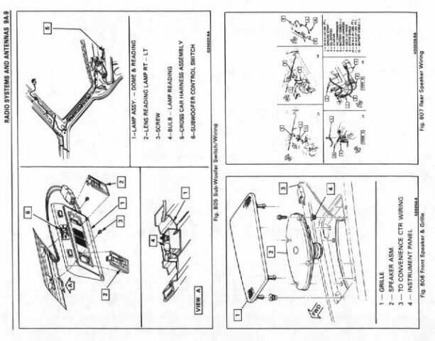

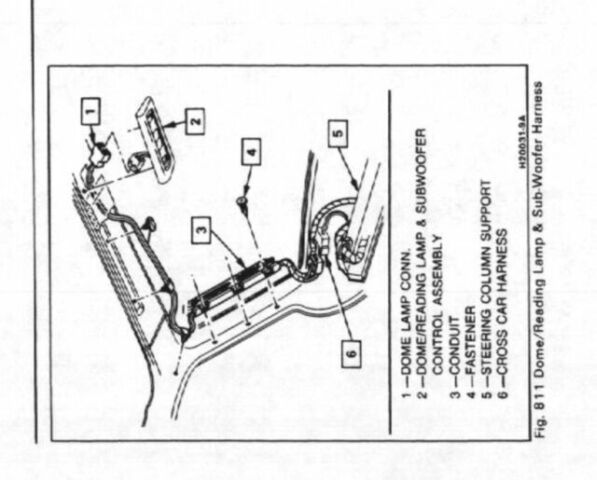

Here are scans from the factory manual I made to help others out.

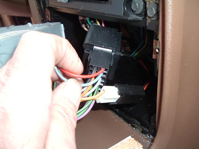

Report this Post01-05-2005 10:42 AM Click Here to See the Profile for WolfhoundClick Here to visit Wolfhound's HomePageSend a Private Message to WolfhoundDirect Link to This Post
Wolfhound
5317 posts
Member since Oct 1999

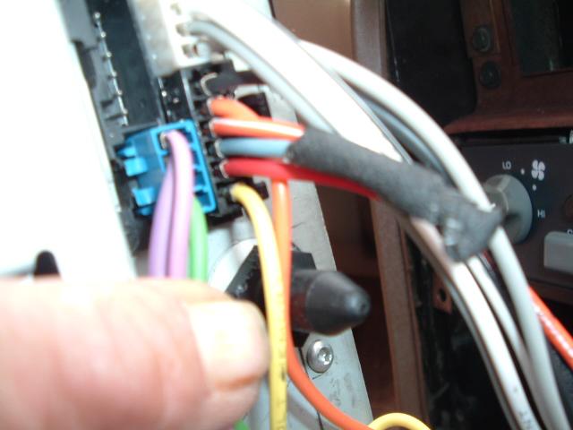

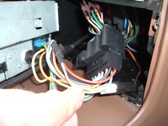

I pulled the cover and radio enough for a shot of the harness end of the addapter. The red and blue wire you see are the only two that you deal with. Note their connection location on the harness end since nothing is written in stone about what color the wire will be on your addapter. The Blue wire is cut near the radio side and the radio side end insulated with tape. Strip the adapter side end. This end is spliced to the red wire. This can be done by stripping a portion of the insulation on the red wire rather than cutting it.Wrap with tape and your done.
this is the opposite end.
This is the splice.
[This message has been edited by Wolfhound (edited 01-05-2005).]
