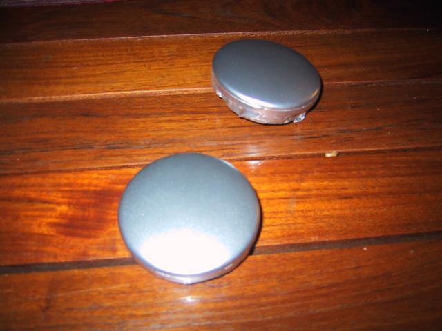

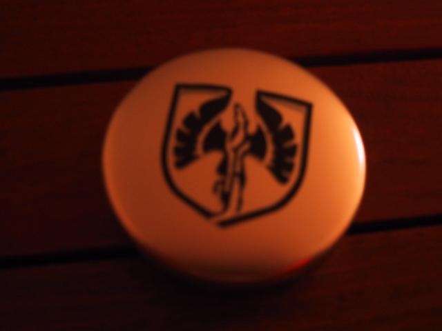

I have taken off the center caps of my rims which had "Dezent" embossed on them, filled them in and painted them with chrome paint from a rattle can.
I want to apply a cut-out Fiero logo. However the chrome rubs off easily and the can says that it can't be clear coated. I tried and the result is bad. Also the foil logo is destroyed by the solvents in the clear coat.
Any ideas on how to protect logo and chrome paint? Thanks

What I did was to print the logo on transparency and then cut it out. I sprayed some clear lacquer down and stuck it down.
The lacquer did not ruin the paint. Clear coat also works.
To be fair though, I ended up buying centers from Pontiac with the arrow on them. The transparencies never did look as good as factory print.
