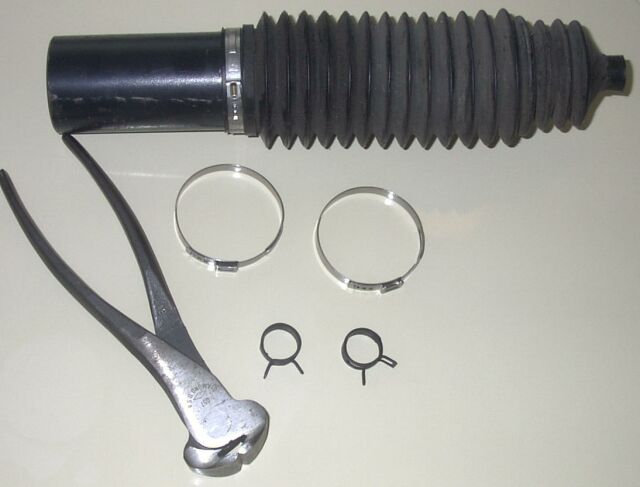

I have OEM look clamps for steering rack boots. Many if not most rebuilt racks do not include OEM type clamps for the boots. The larger boot generally requires a special plyers to cinch them on but I found a parallel jaw nail puller/wire cutter (what is the correct name for those anyway???!) worked just fine. If someone can post a picture let me know and I'll email you a picture of these clamps and that tool. I will also have a free set or two to send out for R&D. Special tool not included.
The large clamps are stainless steel and the smaller clamps are steel with a black plating.

Here you go Rodney. Glad I could help you.

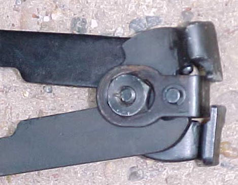

Rodney, the type of pliers you are referring to is Lap Joint pliers. There is also a similiar tool called End cutters.
While these type's of pliers can and will squeeze the crimp of a CV / bellows boot style clamp, they do not have the ability to lock the crimp.
Having used both styles of pliers in the past I can say that without using the special pliers designed to crimp these clamps, the crimp can and sometime does loose tension and the clamp comes loose. Also it is a bit tricky to hold the pliers perfectly parallel to the clamp when squeezing them. This can cause the clamp to crimp crooked, allowing it to slide out of position.
The proper clamping pliers have a 3rd central peice that presses down onto the crimp slightly compressing the top of the crimp inward, locking it.
Some of the crimping pliers have 3/8" drive holes so that you can torque the clamp to the correct spec. In honesty I can say I do not, nor have I ever seen any other tech actually torque a CV or bellows boot clamp.
Here are 2 quick pics I found online of typicial CV / bellows boot clamp crimping pliers.
In this picture there is a close up of the end of the pliers showing all 3 crimping components.
Another problem with using end cutters like in your picture is that it is very easy to chop the crimp off of the clamp if your not careful.
The boot pictured has a clamp installed with the end cutter tool in the picture. I found it very easy to use and it did a very good job. I do have the correct tool here and there is little difference between them. My special tool looks almost the same other than the ends being thinner and having a rounded end instead of sharp. I crimped it very tight and to me it felt I would have had to squeeze a terrible amount more before I felt it would ever cut into the stainless steel in any way. I have no doubt this clamp will never come loose. Keeping it straight did not seem to be a problem at all.
You offered a set or 2 for R&D, well I just gave you 18 years and possibly thousands of that style of clamp crimping R&D, but what do I know?
I have no doubt that you did a good job when you did yours, but you must realise that alot of people are not as careful as you and I.
I debated on posting what I did, I was thinking about this even before ski offered to post your pics, but then I thought " you know some guy is gonna get this from Rodney, slap the pliers on the clamp and give it a good squeeze, cut the thing off, then next thing you see a post on how Rodney's clamps and pliers suck".
On to the 2 sets of pliers having little difference, well, they are pliers, they look similiar. A notchback Fiero looks like a MR2, but they are not the same car.
If you look closely the outboard ends of the proper tool, you will see that it would be impossible to cut off a clamp with them as the ends will not close to the point where they touch. That's just one obvious difference among 5.
Clamping a steering rack bellows boot is the same procedure / method as clamping a CV Boot clamp using this style clamp.
Again, don't take this the wrong way, I know you want to provide only top quality parts and accessories, I just wanted to point out a potential for someone screwing this up and pointing fingers at you.
