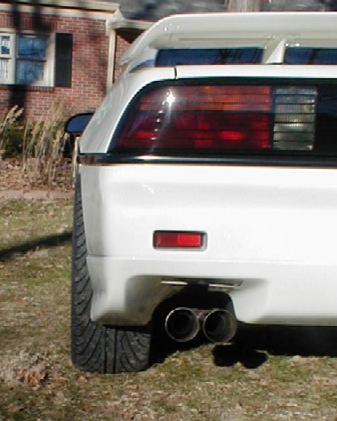

Similar with me except Yokohamas ES100 tires 215/45 & 235/45 on my '88GT those are on 17x7 and 17x8 rims.
RickN
