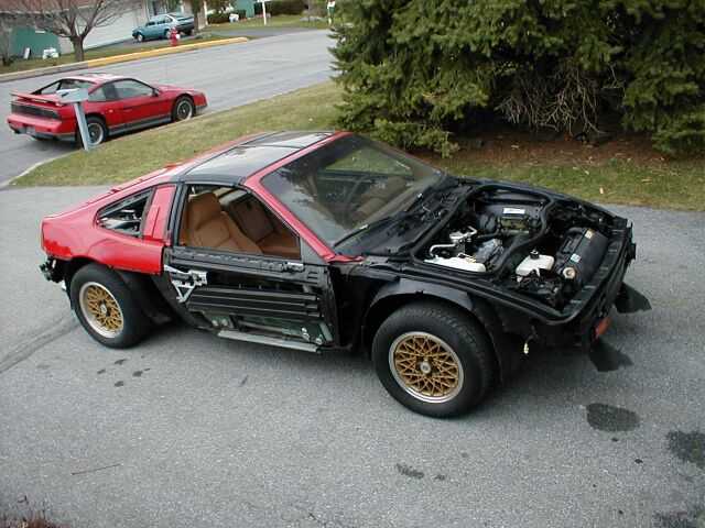

I removed all my panels except the rear clip and windshield piece. Those were painted on the car.
Luckily I had a painter that appreciated what I wanted as a finished product. None of the parts that were not removed had overspray or missing paint. He even removed the trim piece under the windshield which I was going to ignore and he painted that area perfectly as well.
Ready to drive it to the paint shop.
