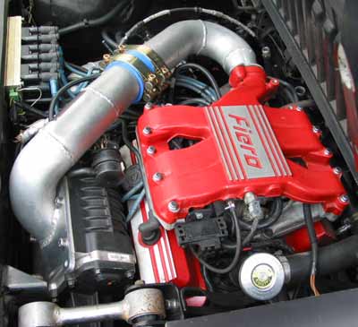

I looked at roots style superchargers before I decided on my setup. I discovered several things.
1 -There was only one SC made for the 2.8/3.1/3.4 engines, but it was for a carburetor or TBI sitting on top,
so the finished job would not fit under a decklid with cutting a hole in it.
2 - mounting a Eaton SC low on the engine (like a 3800) fills the entire space between the heads,
so there's no room for fuel rails or the injectors.
3 - To mount high enough to clear some type of fuel injection, you're back to problem #1
The Eaton SC draws from the end through a throttle body, and pushes out the bottom. I thought that replacing the TB with a side-draft Weber TBI would probably fit well. If that could be made to work, you'd fit everything under the hood and switching to a DIS system would eliminate interference from the distributor.
