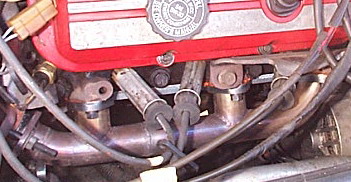

I had the sprint Headers on my 3.4 and they where nice. Remember also that the sprint manifolds are Ceramic coated and keep under deck temperatures low. The quality is great on them as well. I have also seen where the other manifolds WCF and KFG have cracked pretty bad but have never seen it on the sprints. The porting thing is tru but you have a great looking car and the headers really inhance the look of the engin compartment. See my pic.
They also give an nice sound. Here is a link to my header install write up. Notis the S wrench. it is a life saver.
https://www.fiero.nl/forum/Archives/Archive-000002/HTML/20041015-1-041522.html

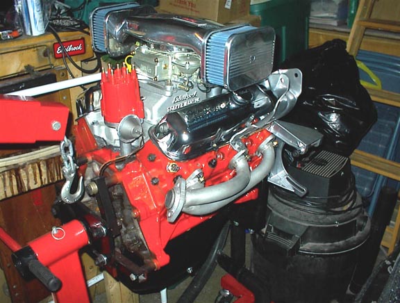

The Fiero Store Sprints are the better choice of the two.
Yes the performance gains are not much more than porting the stock ones, But the Sprints are ceramic coated, If you call in your order you get 10% off ($54.90 off the price makes them just under $500) The biggest advantage the Sprints have is durability. I had Sprints on my 2.8L for 5 years, them moved them over to my 3.4L for another year. Ask PFF member Ditch how they look, He now has my old 3.4L. Never had a crack or any exhaust leaks. The coating lost some of it's "sheen" but it still had a nice even coating without flaking or peeling. Where even porting, re-welding, and coating the stock ones, They can still crack/leak. They bolt right up to the stock "Y" pipe and should have no problems with inspections or emission testing.
Here is a pic of what they looked like when I was building the 3.4L, I did nothing but take them off of the 2.8L and installed them on the 3.4L:

Here are a couple pics I took of the Sprint compared to the stock manifolds. Notice how much better looking the flow path is on the sprints, also the openings are larger.
And for those wondering. This is what the restriction looks like in a stock manifold.

If I may jump in with some blatant self promotion...
Yellowstone, I don't think my headers fit your stealth requirement, but if anybody else is considering spending $500 with the Fiero store of WCF, at least look at these true equal length headers first: http://www.chaserace.com/doug/forsale.html
Doug Chase

Report this Post12-15-2004 12:54 AM Click Here to See the Profile for AaronZ34Click Here to visit AaronZ34's HomePageSend a Private Message to AaronZ34Direct Link to This Post
Now those are probably the best I've seen. THe only thing I'd change is the 2.5" collectors, I'd use 2.25". But that won't make a big difference, as long as you have a decent reducer afterwards. Long, well-sized primary tubes, beautiful long smooth collectors, etc. That is a very nice set of headers, and I'd use those before anything else. Except expect your enigne's sound quality to take a bit of a dive on the low end, but it is worth it for double, probably even triple the hp/tq gains opposed to the other sets.
well, them do look great! any chance of making a set that I can use with my 4 speed trans?
