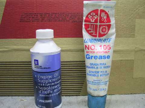

Here's what I have used for the past 25 years (or more, lost count). For engines that were installed right after they were assembled I used the GM EOS except for the cam, where I used green cam lube. I used this method for all my racing engines. If the engine was to destined sit any more than two days, I used the white assembly lube exclusively, even on the cam. It will not drip off, but then it blends with the oil once the engine is running. Oil/filter were changed shortly after. They both cost around $8.00 each. EOS from GM only and the white lube I got from CarQuest. There are other products available, but I had success with these products.
Been using the same lubricants for about the same amount of time and I've had engines sit for many months before installantion and none of them had break in problems.
Lucas oil stabilizer would be my next choice. Anything I've every used with the Lucas brand name has been great. Good luck and peace.
