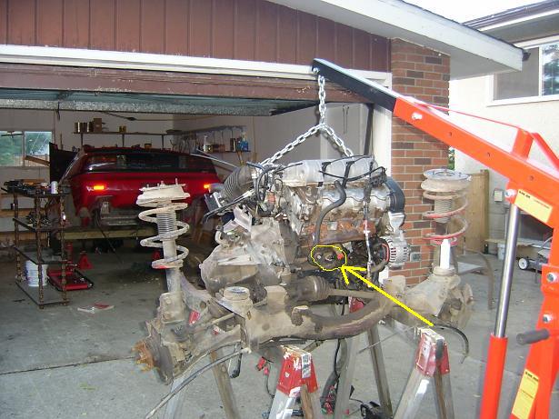

I've been crawling under my car trying to find the darn knock sensor on my 94 tdc and can't see it? It should be on the back side of the motor right?
I have 2 pictures of my motor here. Unfortunatly they don't help me because I had to shrink them to post them on pennock's. If someone could paint an arrow on one of the pictures it would be greatly appreciated

I couldn't see it in the pic, and from where he circled, I do not think that is exactly it, but it is right near there.
Does your alternator have the alternator cooling duct on it? If not, you need one. If so, it is right behind that. You will need to remove the duct in order to see it. If not, get one, well it is below the rear exahust manifold a couple of inches.
The knock sensor is pretty identiable, it should eb a brash colored cylinder, about 1/2" tall, with a hex head and an electrical plug on top of it. It screws in and out. The electrical plug is not standard and be careful not to break it. It is shaped like an oval. To remove it, push the two wide ends of the oval together, forcing it to look like a circle. Then gently rock it back and forth and pull it. To install it, just push it on.

I feel so stupid. It was exactly where Ltlfrari said it was and Erik but I couldn't see it because it already had a connector on it. I pulled the wire that was on it and it wasn't connected to anything. It was also a different color than the one on my new wiring harness.
Anyways, Thanks guys!
