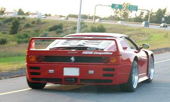

Heheh! thanks, Gary.... Yeah, there still are 'some' parts of a Fiero in there, a manual Rack for one, that needs to be replaced! To answer 'CYNFIERO' 's question..., I'm getting old, fat and tired! My front tires are 255x45x17's(rears 275x40x17), sticky, and are a PITA to turn at a stop, or slow roll! So I'm, like others, are investigating POWER steering racks. So 'ruin a perfectly good sports car' is not a word for me, moreover, the word 'enhanced' comes to mind!
Sandy

'Rickady88GT' I like your setup, nice job! Great for Autocross! In 'my' case, the rear wheels track SO much wider than the front (rearend is 2" under 8') that the car has pretty aggressive steering all on its own! I'm not sure that a quicker ratio would be a good thing.(Well, maybe for "doughnuts") Kudos to you, I certainly enjoyed your build and may still follow your lead...
