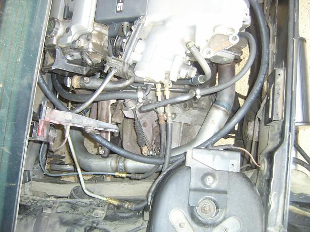

Check out my 3.4 DOHC build thread at https://www.fiero.nl/forum/Forum2/HTML/047231.html but what I did with YellowArtero's car was a little unique because of the shift cable routing of the muncie 4-speed.

I did mine like Darth's. Seems like the only way to go if your using a 4 speed. Make sure you go to a muffler shop that will build it like you want it. I said I wanted a y pipe put in as in a manufactured one and they made this hand made one.... This system shold still flow pretty good. 2.5" seems like a minimum for this motor.
With this set up, when the louvers are on you can't really see the exhaust pipe. Your kind of limited on an exhaust system you can't see unless you go true duals.

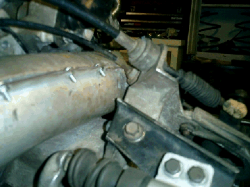

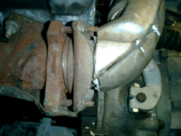

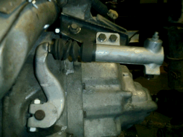

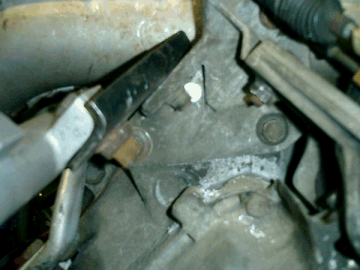

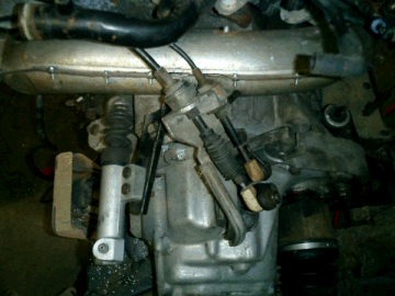

You can use a stock crossover setup with the four speed but you will have to mod the crossover by shortening the ends of the crossover a few inches and rewelding the flanges back on. You will remove the heatshield by drilling out the rivets to do so. Once you shorten the crossover and trim the ends of the heatshield you can put the heatshield back on by using small bolts and washers to clamp it back on.The reson you want to shorten the crossover is to provide clearance for the shiftcables and bracket. You will modify the slave cylinder bracket as pictured by cutting the end off of the cylinder bracket and bending it 90 degree to create a tab then drilling an extra hole in the cylinder bracket tab and the shift bracket where the tab will go Put a bolt through the hole and tighten with a washer and nut. Works great
