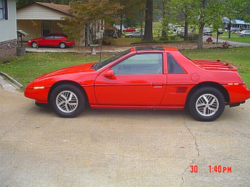

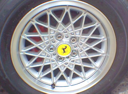

http://images.google.com/imgres?imgurl=http://www.ackerwheels.com/1370.jpg&imgrefurl=http://www.ackerwheels.com/wheels/AW1370.html&h=96&w=110&sz=4&tbnid=IP9CpesjoZ8J:&tbnh=69&tbnw= 79&start=5&prev=/images%3Fq%3Dfiero%2Bfactory%2Brims%26hl%3Den%26lr%3D
sorry bout that, the rim in the top left hand corner

http://www.fiero.org/pix/fiero-r6.gif
this one should work

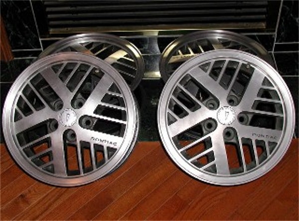

I sold a similar set to a forum member who painted them black with red center caps.
On his car it looked good.
Other guys have done other colours.
You just have to figure what looks good with your paint, trim, and assessories. Good luck

I'm painting my 14" "high-tech" wheels black in the center and leaving the lip bare polished aluminum; much like how the stock Formula wheels are. I finished the left side and the one I spent a lot of time looks really really good. I've received compliments already. The left front didn't turn out as good as the left rear. I spent less time trying to get the paint off and left some of the dark gray between the spokes, so it turned out pretty splotchy. I'm trying to figure out where to buy walnut or glass blasting media in my area, then I'll try using that to strip the paint and repaint.
On the one that turned out very nicely I used Mar-Hyde's aircraft coating remover, the green stuff that'll burn your skin and make you blind if you aren't careful. It comes in a metal can and must be applied with a brush. I spent almost 8 hours on one wheel. It took about 5 applications and LOTS of scraping and spraying with a garden hose to get all of the dark gray paint off between the spokes. The clearcoat came off very easily. If you could find a way to mask off all the spokes and then just strip the clearcoat off the machined face of the wheel you can probably just paint over the dark gray and it'll look fine. The problem is masking off all those spokes would take forever and the stripper is messy and easy to get where you don't want it.. In other words, get them bead blasted!
As for paint, Duplicolor makes a wheel paint in various colors; I heard it works quite well. I just used rustoleum semi-gloss black. It's not chipping off yet and they've been done for a few weeks. The paint did burn off a bit where the wheel touches the rotor, but not where it can be seen without standing right over the wheel and looking for it.
Please post pics if you get them done and let us know what method you ended up using. I still have to redo my front left and the whole right side so I'm looking for a quicker way to do it; maybe bead blasting isn't the only alternative.

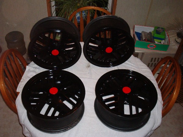

Arn
After I got them from Arn fully prepped, (saved me a LOT of time, thanks again Arn!)
After the paint.
[This message has been edited by Trekker (edited 10-20-2004).]

Report this Post10-20-2004 08:21 AM Click Here to See the Profile for synapseSend a Private Message to synapseDirect Link to This Post
those pics help out so much, looks really good, I will post pics monday. Thanks again!

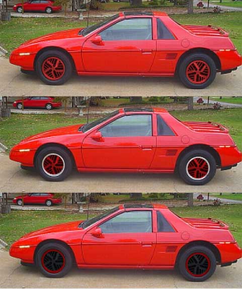

Here you go...
The bottom pic is what I did to my wheels. I'll take pictures when I'm done with both sides and have some time off from work/school when the sun is actually out.
-Steven

thank you so much, I like the first set bottom like you did yours. That does look sweet!

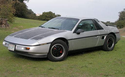

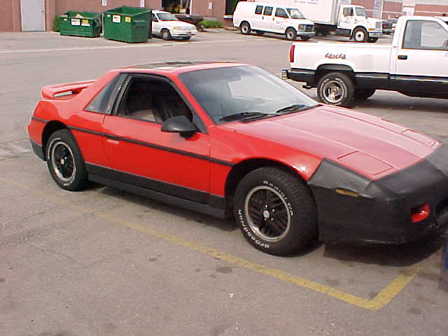

synapse, here's a pic of the wheels on my car:
I masked off the lip of the wheel with masking tape, leaving the edges sticking up. Then I put masking paper on the edge of masking tape that was sticking up, to form a tall barrier between the inside of the wheel (to be painted) and the rim and tire. I used rustoleum semi-gloss black, about three coats with 15 minutes in between. I put the can in a sink full of warm (NOT HOT, the can may burst) water before spraying. This increases the pressure inside the can, helping to atomize the paint and prevent clogging the nozzle. It makes quite a difference!
-Steven

That looks sweet Snyder , is that a 88? thanks for the picture. Now I got the balls to do it seeing how good it looks an yours. I sort of wish i got mine painted silver after seeing your fiero.

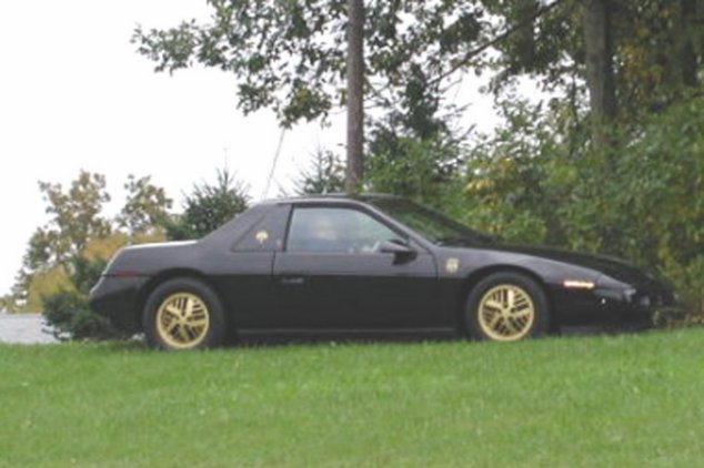

I painted my stock rims about five years ago. I just used spray paint (can't remember what brand). I think I used a semi-gloss. I didn't sandblast or anything extensive like that. I just cleaned them up. Five years later, the paint is still looking great. There are a few chips by the lugnuts and the paint didn't stick as well to the inner parts (the dark grey area), but overall, they still look very nice. The trick is, as with any spray painting, keep the coats light and be patient. Tape the rims off carefully and my taste was to leave the center cap silver. I think it adds a great contrast to the wheel not to mention looks like the GT rims. These rims gain alot of attitude when they're black!!! Much cooler than the silver. I'm kind of new to this message board thing. How do you post a pic?

Very nice job 86SE86GT! When I first saw your pic I was like....GT rims....so what does that have to do with the topic...until I looked closer. They look nice.
