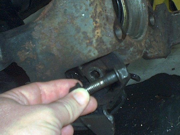

When I took mine apart to replace the axle I noticed that the threads all along the shaft were grated smooth. Given where this comes from and the way it goes up against the pivot;; do yo think this is normal or should it be replaced?
Thanks Jeff

Are you sure that they're worn smooth, or just plain not there?
Every pinch bolt I've ever removed has only had threads at the tail end, where it protrudes through the knuckle & accepts a nut. The remainder of the bolt has been smooth, including the area which would contact the ball joint's spindle.

so---it is a pinch bolt which holds the spindle to the lower control arm and mine is chewed
is this normal? or should I replace it?

The ball joint shaft has a half-moon shaped divet where that bolt goes through. If that divet isn't perfectly lined up with the bolt hole in the knuckle (not just up/down, but rotationally as well), it can damage the bolt threads when you remove or install the bolt.
