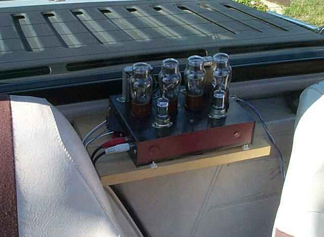

hehe, perhaps a pair of mbquarts powered by a good ole darling tube amplifier?--jk
when it comes to music, its really tought for solid state transistors to beat vaccum tube in quality.
one more thing, the best speakers, sound processor, & amplifiers in the world will sound like crap with cheap speaker wires & rca cable connectors.

Holy sh!t birdpoo! That looks like something from Back To The Future!
But very unique though, I like it.

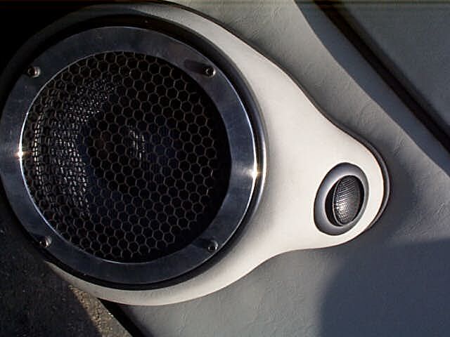

about the pics above: the car isnt a fiero nor are mine.
2 way vs 3 way speakers?
this depends on the shape & size of the cone.
e.g. the stock fiero front dash speakers are 4x10" i believe. its hard to say a 2 way speaker will ever beat a 3 way version of that parabolic woofer shape.
but when it comes to circular non-parabolic shaped speakers, then i would go with 2 way speakers.
hands down component i will choose component over coaxial speakers.
component speakers such as a 6" set (usually comes with is tweeter seperated along with a crossover module.
mid range(6" woofer) & high range(tweeter) are directional in sound these are usually pointed to the listener.
the low range(bass) is omni-directional which means it pointed away from listener.(stowed away).
removing the door map pockets i came up with this 6" components(the tweeter is fully movable too.)
these side door speakers are solely for mid & high range purposes. i get the low range bass from my center console sub
which is a 10" infinity kappa.
