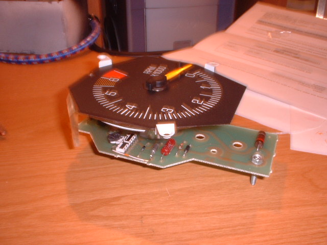

you could buy one alredy done by archie. or buy the partys from him to do it yourself, or find the correct resistor to do it yourself, i have an archie tach that i havent installed yet and it has a varriable resistor, so i guess its adjustable,
if you need a pic it isnt in the car yet, just holla... and ill take a pic 4-U

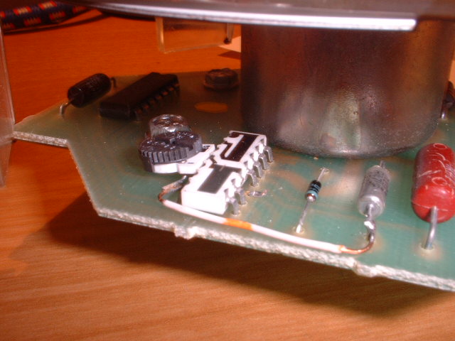

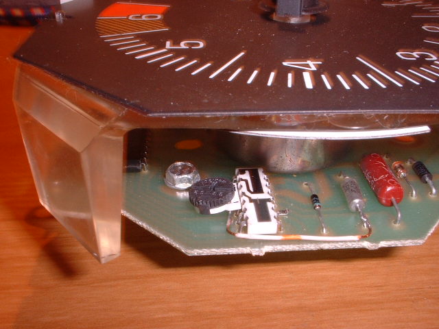

ahh WTF i am feeln' nice, here is what i have, but i dont know anything about the parts i guess

the value that you need to set the pot for is 210K ohms for a V8.
Tim
I bought 2 packs of resistors from my local Radio Shack, (99 cents+tax
each pack)
# 271-1347 pkg of 5 100K-ohm resistor, 1/4 watt 5% tolerance
#271-1335 pkg of 5 10K-ohm resistor, 1/4 watt 5% tolerance
I put 2 100K and one 10K together and i had about 208K
If you do decide to go the resistor route, instead of the 5% tolerance ones,
get the 1% tolerance.
Ed
Edited to get the Radio Shack stock numbers right.

If you go the resistor way and you have a pack of them, measure them all with a good meter and put them one together that will add up to the correct value. You might get lucky at even at 10% to find a set that will add up to the value needed exactly. Best to use a pot (variable resistor) and 'dial' in the value.

You have to calibrate it for your own meter. You can't just say "210k", and that's that. I think I had to make mine ~180k. You just need to measure your original resistor (with the trace cut, so it doesn't measure the resistance of the circuit as well), and multiply by 0.75. I think my original resistor was 230k, x.75 = 173k, so I was pretty close. The 210k only works if your original was 280k.
btw - this works only for the v6 tach.
