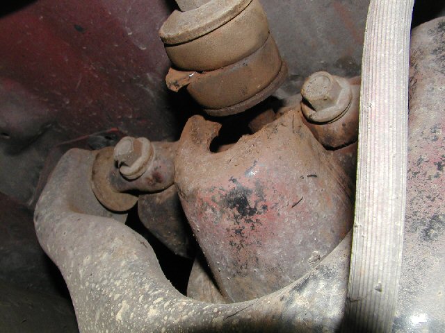

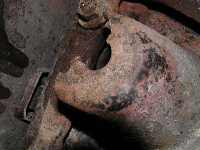

The front cross member on my 1988 GT broke where it hold the shock absorber. This doesn't seem to be common as I couldn't find anything about it in the archives. I just bought the car and was wondering what could have caused this? Was the shock not placed in the correct spot before mounting? Anyway, that's all just speculation, what I really need to know is if I'll need to do extensive repair. I was thinking of just putting two more fender washers on either side of the mount - any advice woud be helpful.
If it came to it, could I just weld a large washer on top of what is left there?
Thanks,
Tom

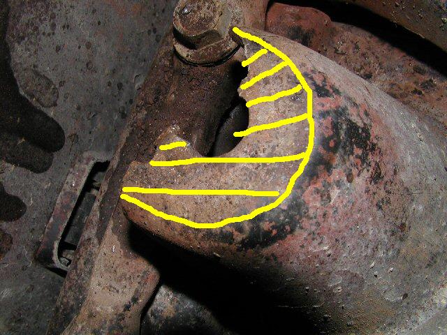

Just welding a washer on there will not fix the problem. looking at the pictures it looks like a metal fatigue problem, things are a little rusty looking there, but nothing that should create any safety issues.
The correct way to repair this is to remove the front cross member from the car. Then you should cut out that top section in a basic geometric shape ( such as a square, etc. Then weld in a new section of steel of the same thickness. I would box in the rear portion of the cross member there to give it additional support. I would also check the other side, and at least box that side in as well.
I would cut out a section something like I have outlined and marked in this pic.
