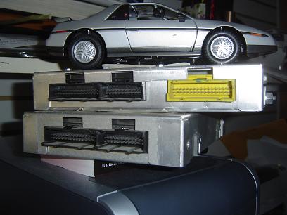

That project is on the shelf waiting for the finish of the Indy Quad 4. Then I can invest alittle time and $$$ into the 3.4 DOHC SC project. I had a change of heart on the computer to use. 1227730 is much better suited to the "Fiero" application then the 1227727. Lets just say that with the 1227730, you can simply get one of the computer connectors (the yellow one) and just move around some of the wires to it and rearrange some others in the stock 2.8 computer plugs, then just plug the 1227730 in, That takes care of most the wiring. Then just wire in a DIS package into the wires that used to be for the distributor. Add a couple wires for the EGR. Done. With the 1227727 you have to splice in every computer wire, or make a harness from scratch. I think the 1227730 is a life saver.
Top one is the 1227730 and the bottom one is a stock 2.8 Fiero computer. See what I mean?

Dude! Those computers are HUGE!! Are you planning on towing them on a trailer behind your Fiero??
