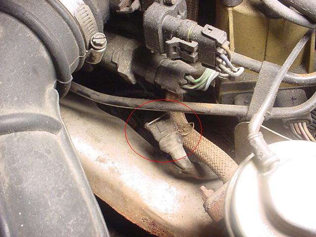

1) The pigtail circled, I found it just lying under my distributer. Where does it go?

cold start injector and yes use a bolt and nut...i win!

1) Looks sorta like an injector wire to me... Could be wrong though...

cold start injector
I suppose its in the area where I found it? Something hard to get to?

The cold start injector is near the base of the distributor. It inserts into the end of the manifold. Here's a picture of it with the distributor removed for clarity, it's the rectangular black connectur just to the upper left of the distributor hole:
