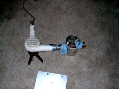

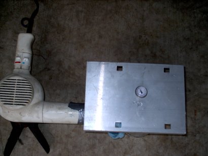

How about a little experiment?
Go ahead and poke fun. Too much beer? Not enuf beer?
Anyways. Measure temp rise over 5 minutes coated and uncoated?
I was gonna do this later. this setup is about 5 min work BTW.

I don't understand what that does? Were you able to test this coating with that set up? If so what results did you find? Did it work?

What I am suggesting is a length of tubing run through a closed container with a thermometer in the container. Using a heat source (hair dryer) to heat the inside of the tube.
Measure the temp at start and then remeasure the temp at the end of a set time, and then coat the tubing and perform the experiment again.
I did this with my cheesy setup and measured a start tem of 87 and an end temp of 105.
The hair dryer might work as a heat source but the closed container should be longer to allow for more heat transfer.
A heat gun with a longer container would provide more "resolution".
