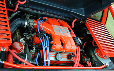

If you look at the passenger-side vent, you will see that the vent is mounted to the top of
the strut. This is where the adjustment is.....

that's a beautiful engine! man I wish I didn't live on a dirt road
