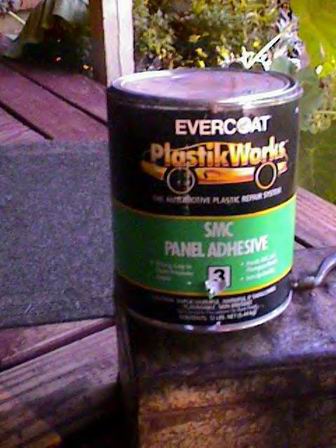

I've been using this with no problems. Most paint supply stores have it on the shelf.
