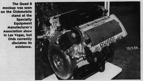

AFAIK, the northstar and quad 4 share no interchangeable parts. The northstar was developed completely seperate from the quad 4. That being said however, there was a prototype quad 8 made, and quickly destroyed thereafter. Maybe someone will post pics.

just for shizzles and giggles:
