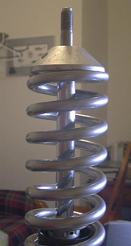

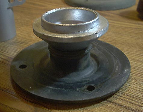

I was wondering if I was going to be able to use the stock hardware for this install, and here is what I think. If I was able to cut the top of the coil spring kit hat that I received from Coleman, that this would be able to center the strut in the position that the stock strut was in.
Strut rod centered in the:
As it sits now, you can see that the top of the "hat" is going to be forced upon the portion of the stock piece.
Is this not a "not so hot" idea, as all the weight and stress is being placed upon such a small area that is going to be prone to breakage?

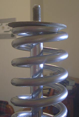

If you don’t modify the hat to sit around the stock part that has the bolts to which you hold the top of the strut, this is what you have to work w:
It seems that this is not a good way to allow the spring to be held into place, as there is a lot of possible movement due to the fact that there is no way to actually center the coil spring to the rod.

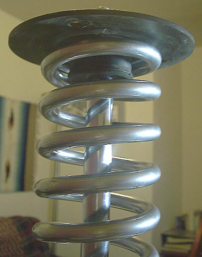

It seems that the same is true if you were to skip the small piece that is pulled off the stock suspension:
So, long short of it…would it be best to mod. the portion of the hat to have the stock part w/ the bolts on it to go over the extension, or just allow it to rest on the very top of the hat?
This is what I did on my rally car. My hat (from Ground Control) was flat on top instead of cone shaped, but I've put it through more abuse than any street car will ever see and nothing has deformed.

Thanks for the reassurances guys, you both got a +

how about cutting the point off of the hat, so that the thing on the fiero plate fits through the hole you now have on the hat?
It might make it weaker though. I think I might try that.
I did it as pictured in the lower picture and have had zero problems with it. The piece pictured in the upper picture should actually go on top of the piece pictured in the lower picture.
