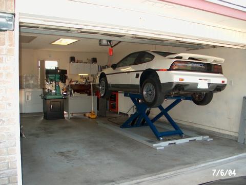

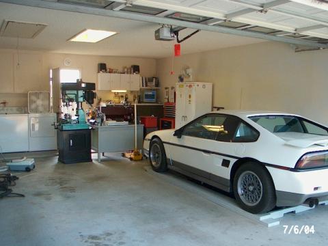

After my dropping my first cradle using the floorjack method I decided to purchase this BendPak scissor lift. You won't regret getting a lift. It makes everything so much more enjoyable.
On the ground, small ramps are needed to clear undercarriage.
At maximum lift.

I was wondering how that folding jack type worked. Can you roll the cradle underneath without hitting the feet? how stable is it when raised? That looks real handy and with a 3.4 dohc swap I know I will have it in and out a few times!! Not to mention my other projects.

Although I haven't dropped the cradle since purchasing the lift I can tell you without doubt it will work beautifully. It lifts vertically without forward or rearward movement of the chassis. At maximum lift the car is very stable. When working underneath I have a little wheeled mechanics stool that I sit on that makes it very comfortable.
Now, having said all that, if I had a 3 car garage with one RV sized stall I would have purchased a 2 post lift so I would have full access underneath the vehicle. The 2 post lift is more versatile than a scissor lift if you have the appropriate space for it. The scissor lift is a good compromise though.
For those interested, the Bend-Pak scissor lift I have is from Northern Tool. When I bought mine the deal was free shipping and six months no interest.

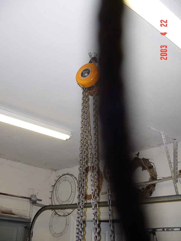

For $50 for a chainfall and $25 for a chain with hooks you can lift the back of the car off the cradle. This assumes you have garage ceiling joists stout enough to take the load of the chainfall:
