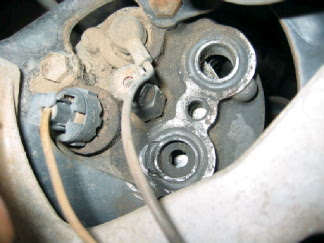

This is a pic of the rear of a compressor, not sure if it's exactly the same as your but it should be OK.
The larger opening is the suction side and the smaller opening is the discharge side.
Pour the oil into the larger opening and then turn the compressor over by hand several times, you can do this by turning the center that the pulley rotates around, this will distribute the oil inside.

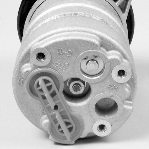

Aren't most GM replacement compressors shipped dry? PAG oil (GM recommended) is extremely hygroscopic and would suck up water if not tightly vacuum sealed or pressurized. Also, a replacement compressor may be destined for an R12 system.
Heres a HR6 picture clearly showing the discharge (D) and suction (S) ports.
