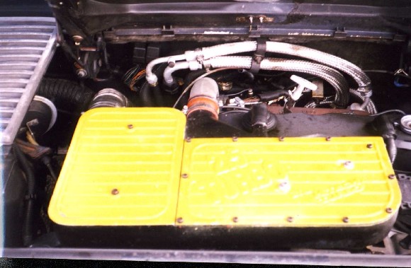

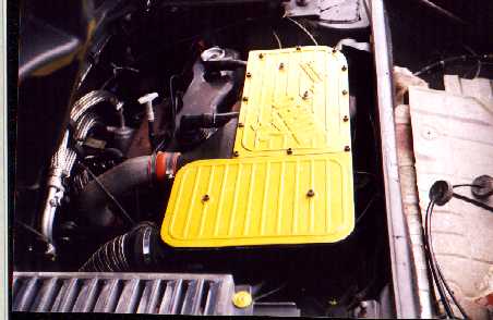

Report this Post06-10-2004 01:21 AM Click Here to See the Profile for TugboatSend a Private Message to TugboatDirect Link to This Post
The first 2 pictures are of his Super Duty block and crank, the SD rods are mentioned in the caption.

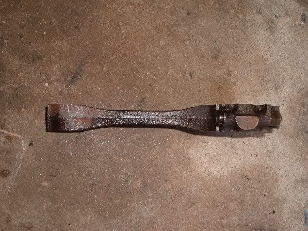

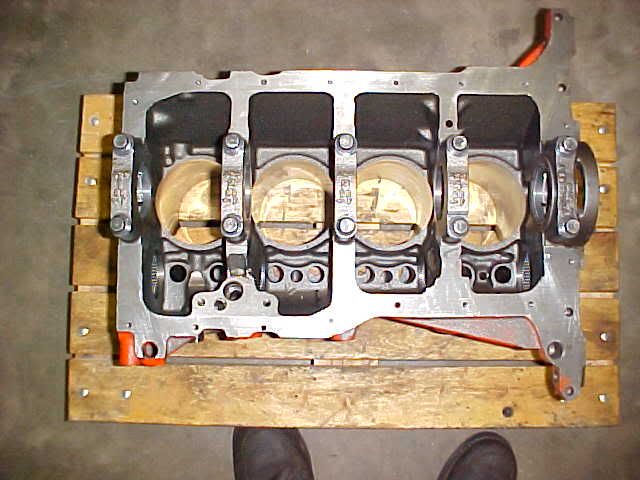

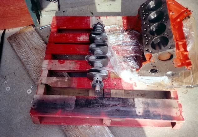

Why does this always come up? What kind of experience does it take to count? Why continue to ignore first hand experience? I say the Duke is weak. You know what? I have three Duke blocks and cranks sitting in my garage. The sidewall and main bulkheads of those blocks are about .3" in most places. That's pitiful. The SD block is .7"-.8" thick on the sidewalls and main bulkheads. That's three times as thick.
Here are pictures that I took:
That's a cleaned up Duke rod. It's sad.
Again, my own crankshaft. It sucks.
Again this is my SD block and SCAT billet crank, 3.100" stroke. It doesn't suck.
I'm not trying to be cocky, just provide some credibility. I don't want to say anything that would end up taking this thread to the can.
Two questions:
What forms of racing are the stock Iron Duke blocks used in? Some websites would be nice.
Which bolt on parts will get you another 30hp to make it competitive against the stock V6?
The Iron Dukes are prone to cracking and failure if power is increased to any level beyond stock. Some parts are already at their limit.

Here's a couple more pics:
This:
Versus this:
You can tell how much thicker everything is.

Report this Post06-15-2004 06:20 PM Click Here to See the Profile for BV MotorSportsSend a Private Message to BV MotorSportsDirect Link to This Post
BV MotorSports
4821 posts
Member since May 2001
Since Dennis brought it up, here are some pics of the IRM/Hi-Tech turbo duke. This is the as purchased condition. Some may have seen this car down at the Fiero Factory. It belongs to a guy in Williamsburg Va now and its coming along REALLY nice.
