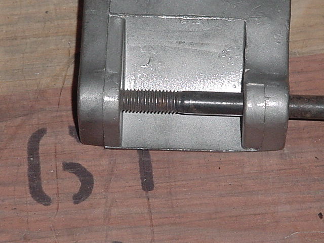

I've seen some that did not utilize the bushing. The ones that don't us it are the exact width of the thru bolt sleeve on the alternator. Check it and see if that is the case.
Here is a shot of one that doesn't use the sleeve.

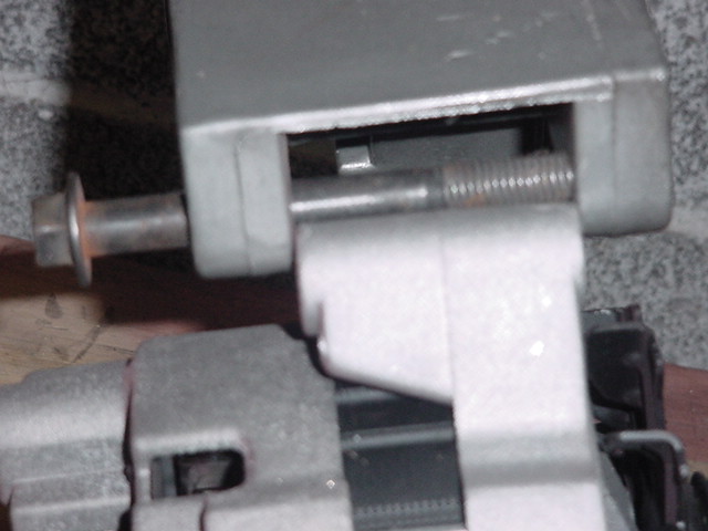

And as you can see here in this shot the alternator fits exactly inside. This is an 88 alternator but that portion of the case is the same as earlier models.
I have looked to see if I have one with the bushing and at this time I have none. I do have three of this type though. One is still mounted to the 87 engine it belongs to, another is on an 85 engine. If you need the bushing for yours, I think the one in the A/C bracket is the same thing.

Indiana resto guy, yes that did help, went out to the garage found an old alt and tried it in the bracket, damn if it wasn't exactly as wide as the bracket opening. But the bolt is still a very loose fit in the bracket. Just seems like wear and movement would be an issue.
