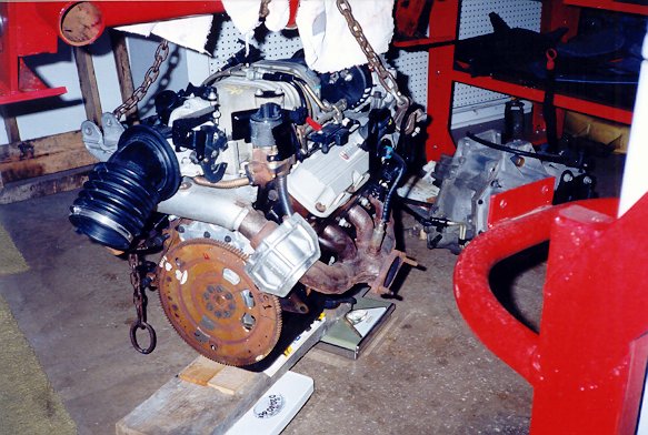

Here's a picture of my 3800SC being weighed. At the time it had no A/C compressor. - 468 lbs.
I also weighed the 4T65E-HD - 210 lbs. GM gives a weight of 214 lbs. wet.

thank you
so that's 683lbs. 3800sc + 4t65e
hmmm, about 200lbs extra weight ...
