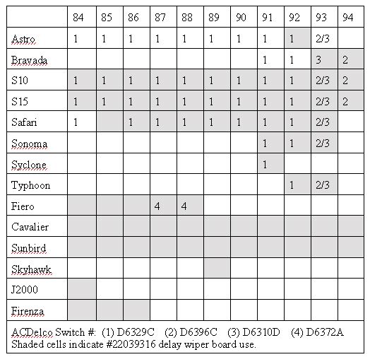

Here's a chart with information from the ACDelco.com site. The shaded blocks are the models that use the same board as the Fiero, according to Delco. There are some errors cause we know the board wasn't used on the 84 Fiero or S-10 but it is generally correct. The numbers indicate the column switches that might also fit a Fiero. Some models such as the Cavalier have the wiper switch on the dash but they still use the same pulse board.
