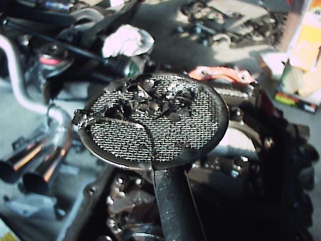

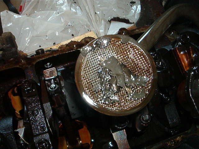

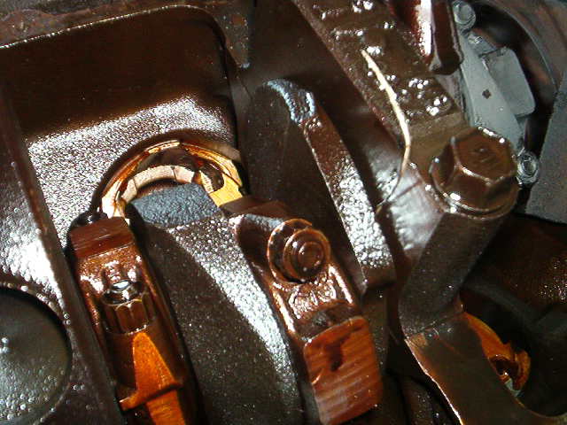

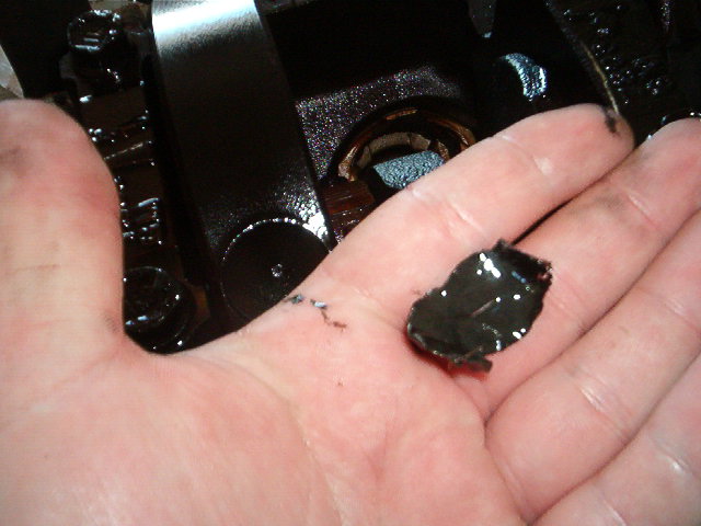

hey all.. I recentally got the bottom end apart and found some (whell, quite a few) metal shavings floating around the bottom end.. the oil pickup screen is almost completally clogged, and there are some bits sticking out from the 2nd bearing back from the balancer. Im going to get some pics up of the stuff once I get PIP downloaded and working.. what could have caused this problem? I am hoping to get my hands on an engine stand so I can get this completally apart and get a good look at the crank. :S I really hope the crank isnt done in.. if so, then I will just have to get one from a 3.1!
note the chunk sticking out of the main cap
these arent small chunks..

Those "bits" from the second bearing are bearing. CAUSE- I would guess the engine uses oil as was run low, No oil equals no bearings. You will no doubt find that the crank is in need of grinding. So get ready for a overhaul!

yes, I would guess them be destroyed bearings
cant think of anything else that would be
but, you will see as soon as you start taking caps off
I have heard 2.8 cranks cant be re-ground, but dont know for sure.
