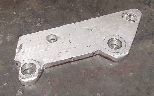

I don't believe you could make this shifter work without using the adjustable style automatic cable. We used the stock Fiero cable and that required a custom adapter to be made to move the attach point to further to the front of the car as well as over to the passenger side. Here's what one of the prototype brackets looks like, and it's close to what we ended up with except the top holes ended up being about .9" further back and slotted for an inch for more adjustment.

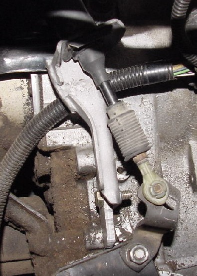

Here is what the completed assembly looks like at the transmission. As you can see, adjustablility is the key. We set it up with the transmission and shifter in neutral and then locked everything down. Several things had to be tweaked. You can see where the cable mounting bracket has been cut and the angle changed. The mounting point has also been moved from the outside of the transmission case to the inside and even further to the passenger side by mounting it on that side of the new adapter bracket.

The Fiero has (at least) two different auto cables. One is a fixed cable with no adjustment and the other is an adjustable one. The cable, shift arm, and cable mounting bracket are all unique to the two cables. I first did the layout work for the fixed cable but that was pretty tricky to do and the adjustable one made it much better.

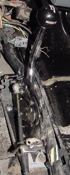

The shifter itself mounted on a piece of 1/4" aluminum plate that I had laying around. 3" would have been better since 2.5" only allowed 3 of the 4 mounting bolts to be used to mount it to the floor. 3 is more than enough, though, so that's not really a problem. You'll need to cut the end that retains the cable off of the old shifter and weld it on the back of the new shifter to use the original cable. The cable that comes with the new shifter is way too short to work, but you could probably order a longer one and use aftermarket. As far as I can see, I don't know of an aftermarket source for the automatic cables in the Fiero. I didn't check if they were still available from Pontiac, but the Fiero Store doesn't list them and they aren't available from the parts houses.
The bracket I made is also from 1/4" plate and we pretty much just rough band sawed it out and cleaned it up with files and die grinder. The cable mounting bracket needs to move more towards the front of the car and up. You'll bolt the cable on with the nut DOWN now, instead of up. The angle is also changed on the mounting bracket by cutting and welding. No mods were required to the shift arm. You might see a little grinding on that one in the picture, that was when we were using the first bracket and it didn't move it forward enough at that point.
The position of the retaining bracket is pretty critical. Not just the distance, but the angle it sits from the shift arm. If you think about it (and I know you will), you can see why. On the Hurst shifter, the ratchet action moves the cable almost exactly 3/10" on each ratchet stroke, but a different amount when moving it from P-R and R-N. The arcs have to be right or you won't hit your detents in the shifter and the arm at the same time.
The best location to put the shifter side retaining bracket is where it is on the picture. I ran scenarios with it everywhere from an inch above the handle down to way below the base of the shifter and by locating it there and using the adjustable cable, I managed to get the computer to hit the detents in the shifter and transmission to within about .070" of the cable stroke. There's enough slop in the cable to make up that much difference.
