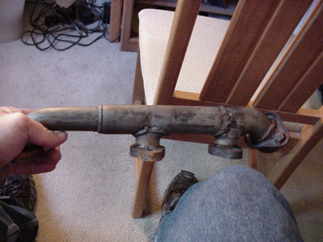

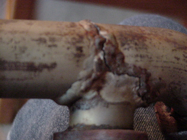

hey just a good idea of where too look. I assume the 2,4,6 cylds are the firewall side manifold? Well Here are two pictures of where I found my leak.
Note the cracks happened on the weld line? Now Granted mine was ported at an earlier time and rewelded, but this is what can happen. just look around where the cracks are. Take a Mirror and posission is so you can see the bottom of the manifold. and check your crass over pipes, you might have a leak there too.
Oh and it will tick all the time but the more exaust flows through the crack the more you will here it.
