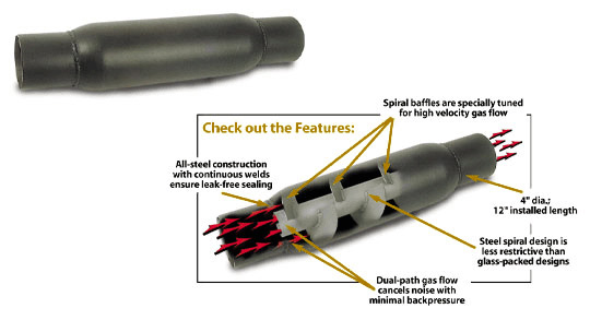

I'm putting one of these on my GT. They are designed for race tracks where the exhaust has to be below 95db. The question is, will a 2.5" CATless exhaust really be under 95db?
Arn
Uhhh.... ist that just another fart can honda muffler?? I would reconsider, its more than just the annoying "pissed off weed wacker" noise, anytime I see one of those I just know its some sstupid ricer that thinks its cool to sound like a moped. Some friends and I saw a pair of those on a firebird, and we just cracked up.
No, it's actually not much of a muffler at all. These are specifically made for race cars. They don't offer much restriction and they don't quiet the exhaust down much. They're what you use when you need to knock off 2-3 db to be legal. Rice boys don't like them because they're not shiny and because they don't have a 2" inlet and a 4" tip.
Ca_extreme, in order to determine anything useful about your sound limits you need to get ahold of the testing procedure that the smog stations will use and duplicate this exactly.
The reading on the db meter will be affected by many different things. Sound intensity drops with the square of the distance. It will drop considerably if you're off to the side 45 degrees instead of aiming straight at the exhaust. If you're on pavement the reading will be a lot higher than if you're on dirt. If there's a wall behind the car the reading will be a lot higher than if there's not. Once you find the exact procedure you'll probably find that your car is legal.
Arns85GT, the same applies to you. Yes, racers use those mufflers, but most tracks have a db limit that's specific to the track. Some tracks measure 50' from the track. Some tracks measure at the property line. In these cases, racers can often meet the limit (legally) just by putting an elbow on the exhaust and pointing it away from the sound measuring station.
So again it's hard to give an answer as to whether this muffler with no cat will get you under 95db. 95db 10feet behind the car at WOT? Probably not. 95db 50 feet from the car and off to the side as you're driving by? Probably.

When I have the car running, I'll try to record the sound for a postable sound byte.
I suspect it is quieter than a glass pack and probably along the line of a Flowmaster 40
There are 4 baffles, which is technically more than the Flowmaster.
I guess I won't know for sure until I fire it up
