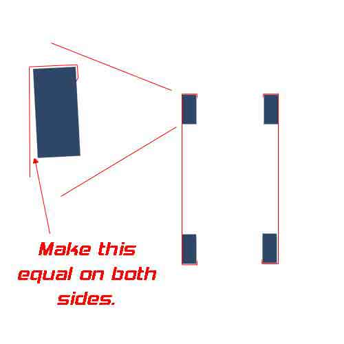

loosen the nut and put some vice grips on it. I did mine while the tires were on the car.
On the BACK tire run a string from the back of the tire wrap it around to the front of the tire so it touches both sides of the tire. Then run it to the front tire and tie it off to the frame somewhere so it touches both sides of the tire.
Do this on both sides of the car. Put your steering wheel in the middle.
Now adjust the tie rods till the space from the back of the front tire is equal to the string on both front tires.
Mine was about ¼ inch.
