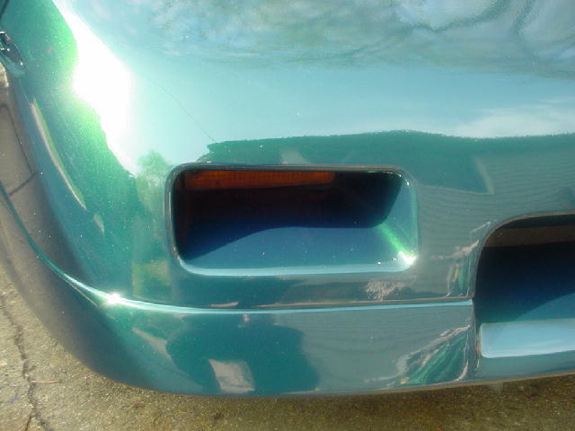

There have been several questions about how to sand out spider cracks in bumper covers, and since I was doing a little bit of that tonight, I thought I'd take a couple of pics.
This is a front directional pocket on a GT (duh) and it's been repainted once. Who's car might this be?

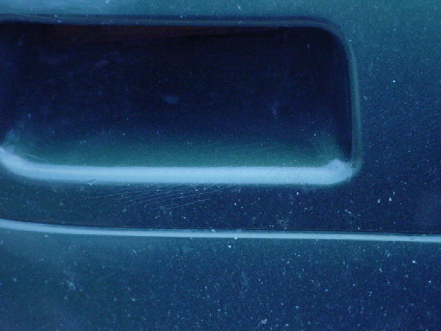

You can see the cracks in the current paint. There are several more areas that need attention on the cover.

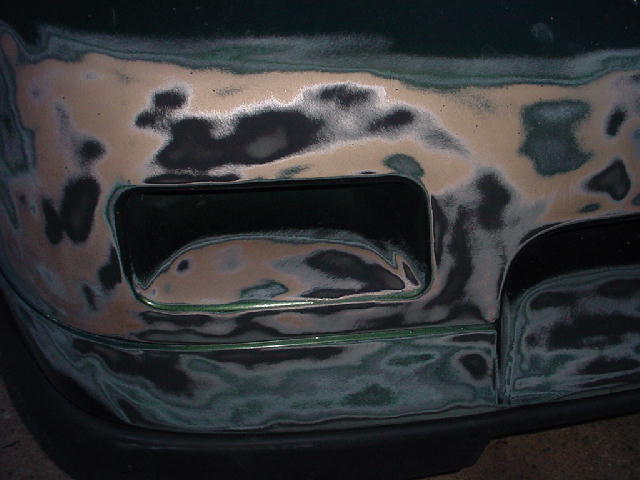

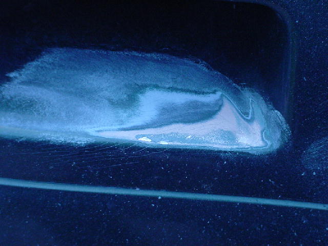

I sanded through the second paint job and you can still see the cracks in the factory paint.....so, more sanding.....

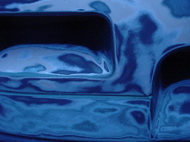

Finally, no more cracking paint......because no more paint to sand off! I used 80 grit on a D/A to get through the paint layers, and before I sanded through the primer, I switched to 180 grit. Once I'm finished with the sanding, I'll prime the cover with epoxy primer, block sand with a flexible block to make sure the contours are perfect, then go to the rest of the car.

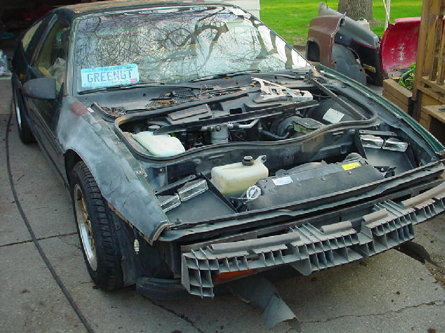

Here is the finished cover...and it's not even wet sanded yet! No cracks are there, because the cracked paint was removed.
I tried to get it a really nice shade of pink, but the owner was standing right there......
This is what it was bolted onto when it was done.....
