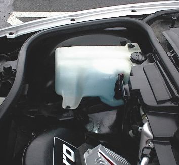

I am thinking about swapping out my windshield wiper fluid reservoir (holds a gallon I think) for the smaller one (holds a half gallon I think) that came in the 84 (85 also?) model (to free up a little more room in the front cargo area for more electronic goodies).
How easy can this be done? Is it just a straight plug in? Anyone done this before? Pics? TIA!

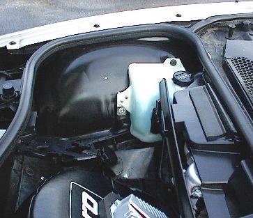

Um... well, I decided to just chance it... so I hit the ole junkyard and found 1 of the small reservoirs & pulled it. After a good cleaning, I took out my big reservoir (left the original pump hooked up), put in the "new" old small reservoir, and placed the original pump into it (it fit like a glove), tho I did have to drill a hole into the fender to hold down the front since the bigger one was held down by the jack holder. Tested it out... and it worked just fine. I am so smart... S-M-R-T

Run only water in it for a month or so. Those pumps can start leaking once you mess with them. It doesn't take much on old ones. The stem seal and the pump itself get crabby with age. I just had to replace my pump because a seal failed and leaked out all my fluid. (Took days to leak out...) Pumps are cheap. $15 for one with a "Limited Lifetime waranty" at advance auto. about the same elsewhere.
Living where I have to use my tank allot, a smaller one would drive me nuts. I'd have to fill it couple weeks. I use a couple gallons just in the short winters in DE.
