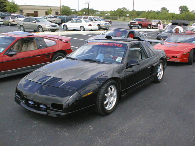

done right they look allright.
98 3800SC GTP motor,3.4 pulley, Getrag 5sp.
custom hood, trunk, side scoops, IRM front spoiler, 17" excel's , dk.Shadow Grey

revin - cool lookin scoop on that car, i might do something like that after i swap in my 4.9 - gg - first things first.
